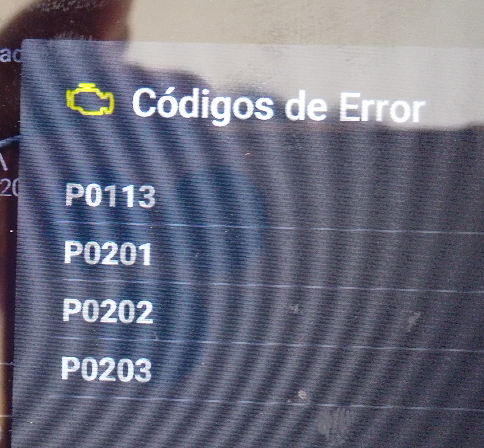

    Well I found something... I used the tuneecu app and says that there are problems with the injectors and temp sensor from the admission, open circuit, shorted to possitive
    I attach the pic for the codes, maybe I'm loosing something on the translation. So no gas and where is that sensor at?

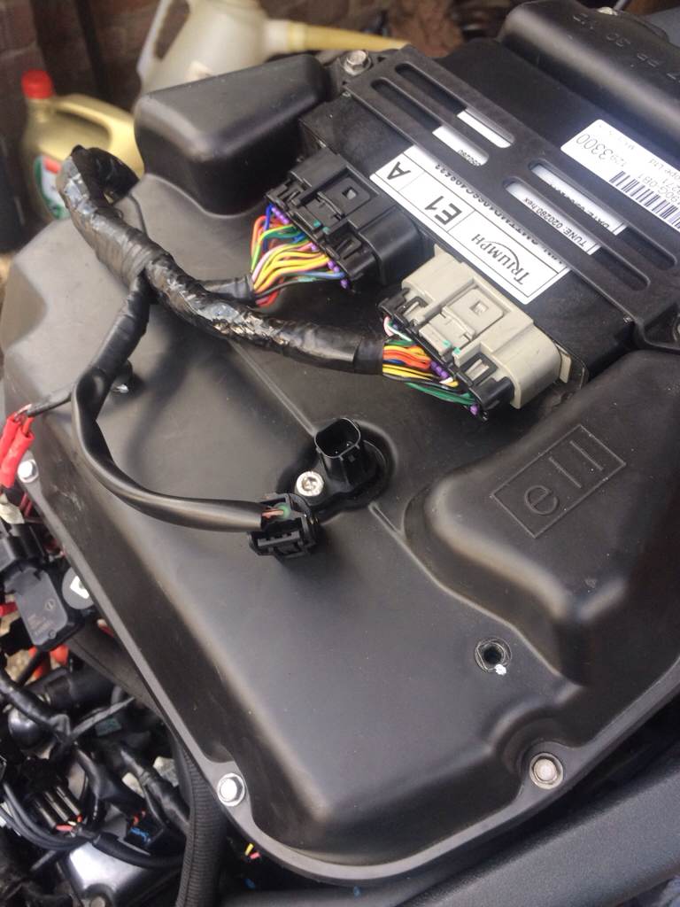

    So you've got a few issues there, the intake temperature sensor which is error code P0113 is on top of the airbox, it could be a simple case of its not plugged in, but its a simple swap out if you lift the tank, it's held in place by a single bolt. Found the picture on this site, so I know that's the one. As you'll see its right below the ECU, just undo it and replace.
    The second, third and forth codes point to the ignition coils which if you remove the airbox you'll have access to them, you'll want to have a look at the wiring going into each plug as I know they can become brittle over time, break and cause issues, a good replacement option for the plugs is to simply buy a spare harness for the bike off ebay, then simply cut and splice in any replacement plugs you desire. Job done and you'll always have spares if you run into any other issues.
    However, if you've unplugged anything while working on the bike and turned the bike on, the error codes will pop up, so clear them off first and see which ones come back, if they all come back then proceed to check and follow the above suggestions, clear the codes again and see what happens.
