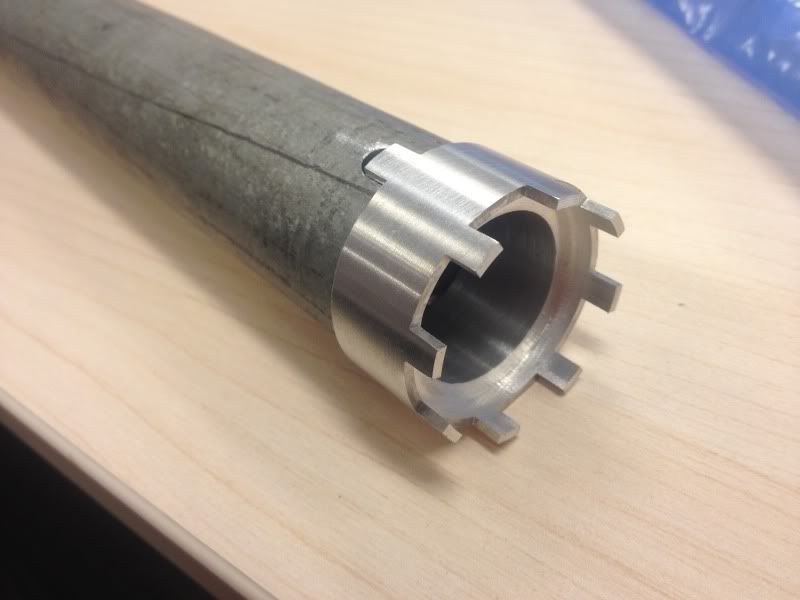

  6. petekeys
    petekeys
    hmm just had a quote for the tools
    00797-08 £53.67 plus vat
    01765-03 £39.57 plus vat
    01797-07 £67.43 plus vat
    which is £192!! And 3 week delivery
    I was thinking it might be useful to have the tools in case I wanted to swap the springs in future but its not worth it at that price.
  7. scaramanga
    2,711
    190
    theres a how to guide somewhere with home made tools
    not sure if its on a forum or youtube
  8. Attached Files:
  9. scaramanga
    2,711
    190
    i think ive seen something on youtube possibly under upside down fork oil seal repair/change
    the 1 i viewed wasnt home made tools but just using other things like screw drivers and other comon tools
