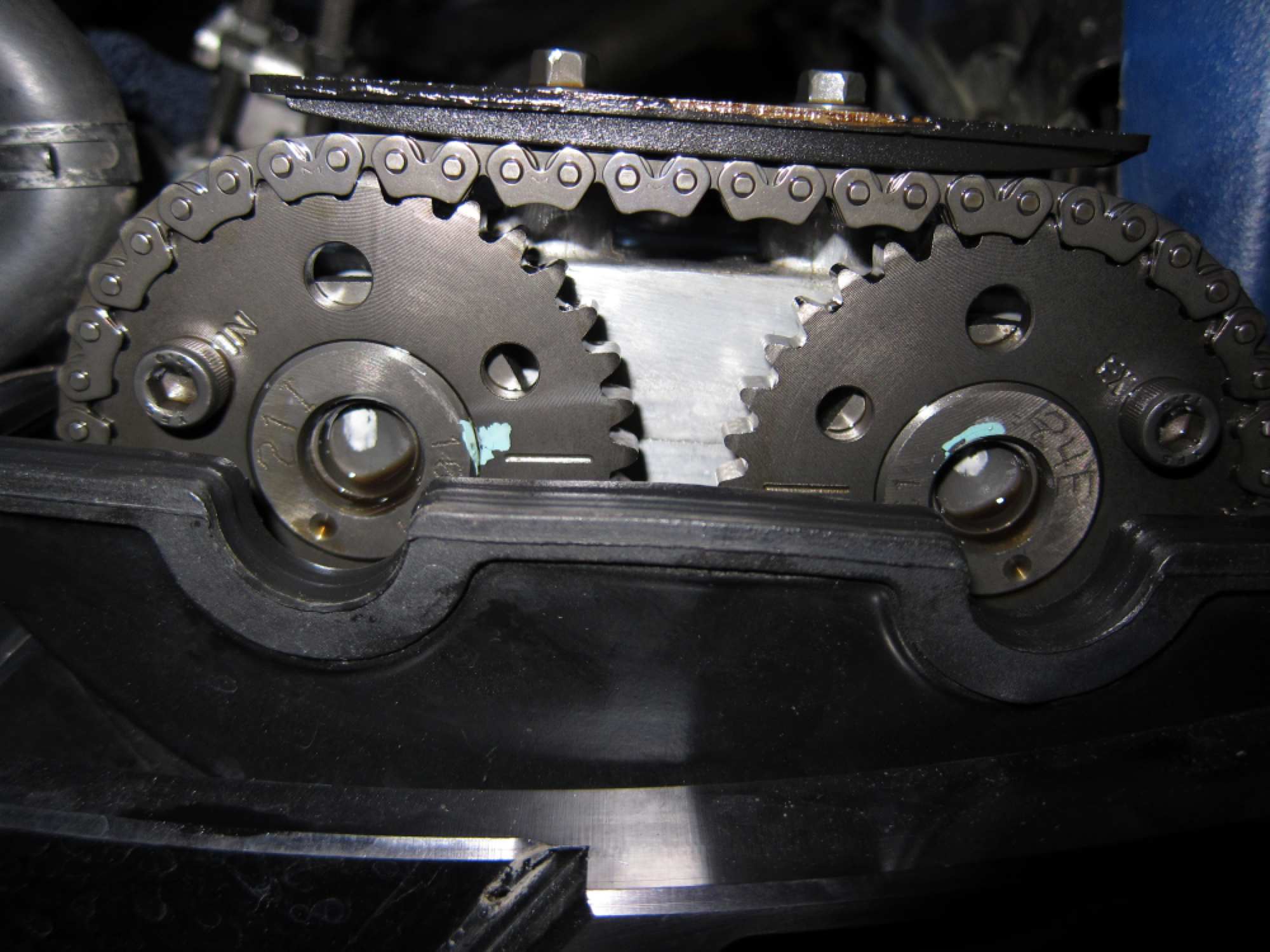

    I'm a little confused at what position the cam lobes should be in when checking valve clearances.
    Should it be when all the valves (all 4) for a single cylinder are pointing directly away from the followers or should it be when the cylinder is at TDC on the compression stroke which I believe is when the lines on each sprocket are pointing inwards in line with the head like this:
    and the punch mark on the primary drive gear lines up with the mark on the crankcase like this:

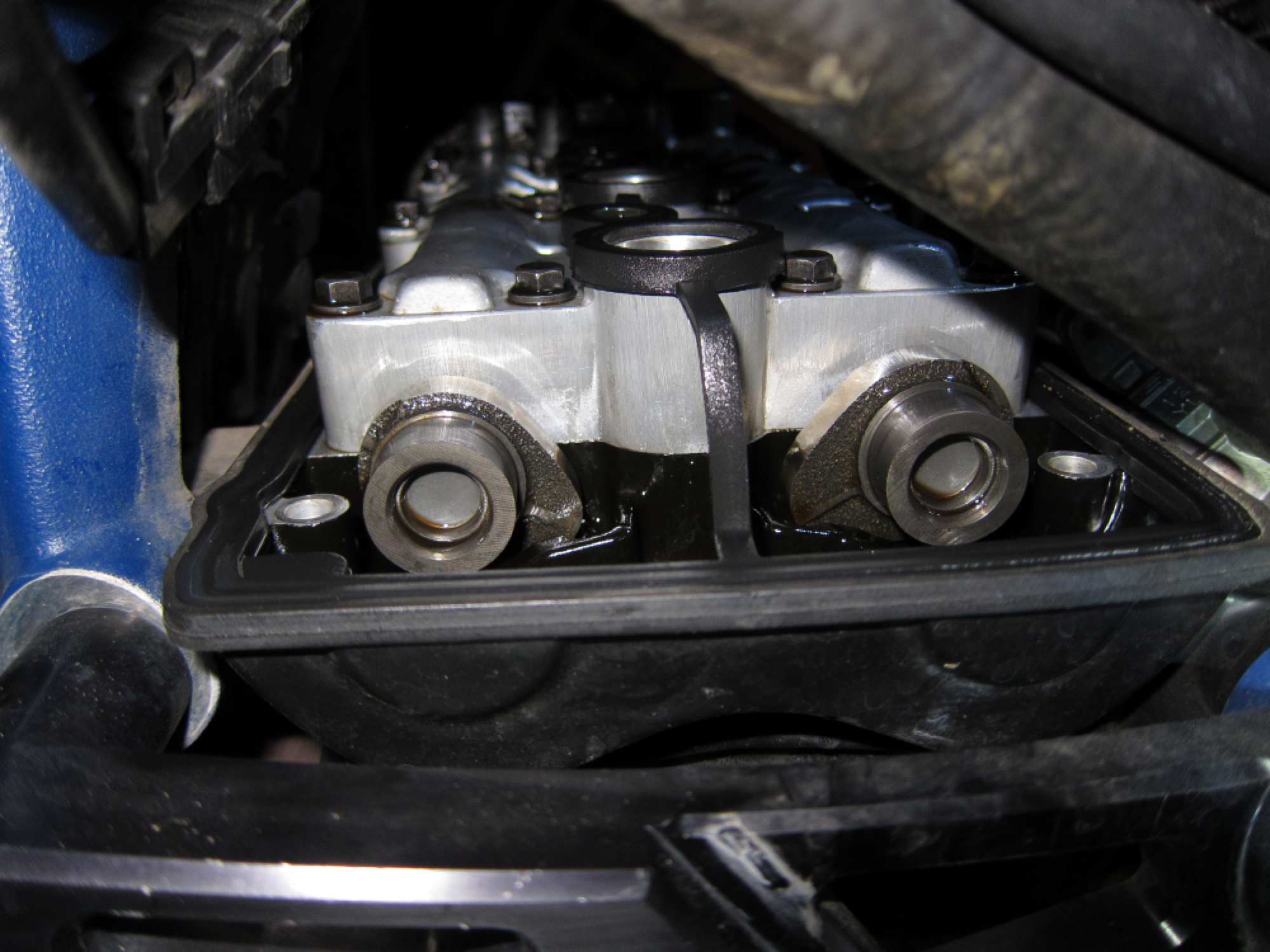

    Because when it's at TDC the valves may all be closed but the lobes are definitely not all pointing up:
    A bit confused because the Haynes manual says to do each cylinder at TDC but then has a picture with the cam lobe pointing up. :?

    You should be able to do all 4 valves on a single cylinder at a time as all 4 will be shut on the combustion stroke.

    have the lobes actually started to engage the valve though?
    they look to me like they have either just come off, or just about to push on.
    to be absolutely sure, it would be with them vertical, but if you can get your feeler gauge into the gap, then they are probably not engaged.
  8. Frogcake
    Frogcake
    Moderator Staff Member
    1,931
    106
    Yeah I think the valves are fully closed in the pic but to be sure I just rotated each pair of in/ex valves until the lobes were vertical.
