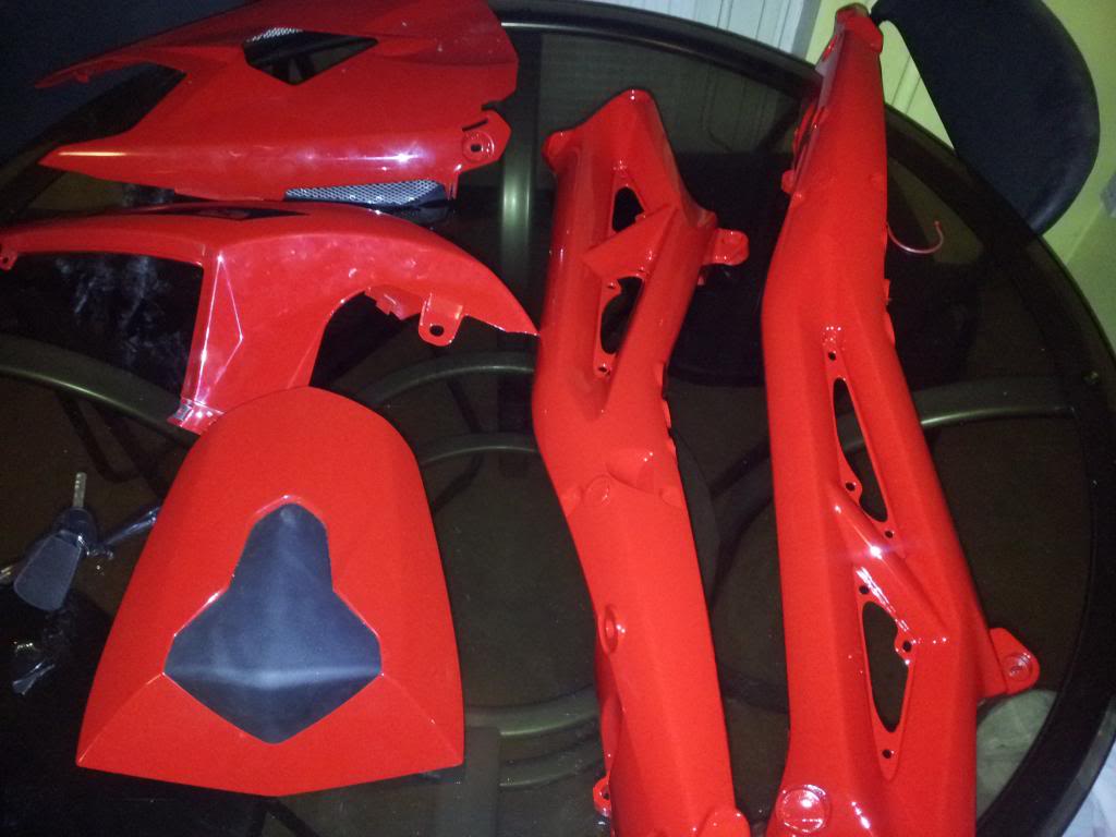

    Decided to paint my rear subframe and after getting the paint i wanted i started prepping/painting it today (Saturday 14/12). For some reason triumph went with a greyish silver for the subframe of the Diablo red 2013, a completly different silver colour than the eyelids/ intake frame with a darker dull tone. After painting the other silver parts black the subframe looked out of place imo so why not paint it ? The dupont Triumph DR matched pretty good, a smidge brighter but once it's all dry and cleared it will match allmost perfectly .
    Masking threads and prepping the surface for paint, just sanding down the oem paint slightly. No primer is needed since there's no bare metal parts:
    After 3 coats of DR :
    After a few days the colour has darkened somewhat and when compared to the stock rear fairing pieces they're pretty close :
    Will leave this to cure properly for a week and then wetsand/clear with 2k clear, wait another week and wetsand with 2500 k paper and polish with Meguiar's Ultimate compound. Getting twill carbon inserts from Jacques @ http://www.carbonfbr.com instead of the ugly plastic ones.

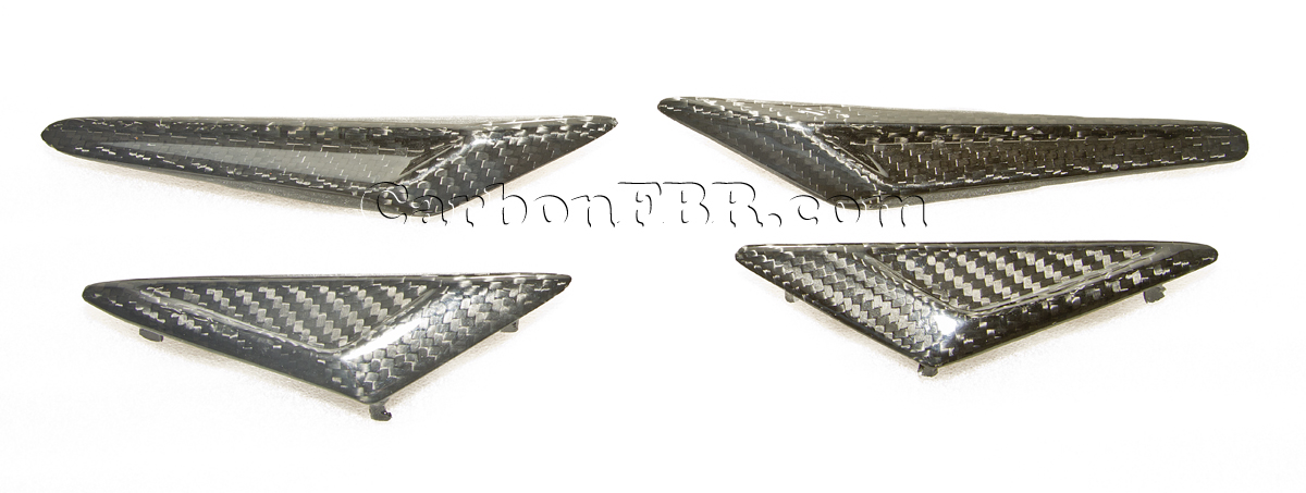

    Got a few pics of the inserts, he will have one additional set in stock beside the set i'm getting. Pretty damn sexy.

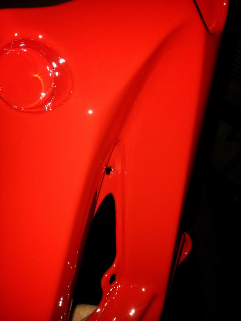

    Cleared with 2 component clear, very durable and resistant to gasoline etc. Very satisfied with the result, wetsanded with 2500k before laying 3 coats of clear. Normally you would wetsand and polish to a shine in the final stage but i don't need to now tbh.

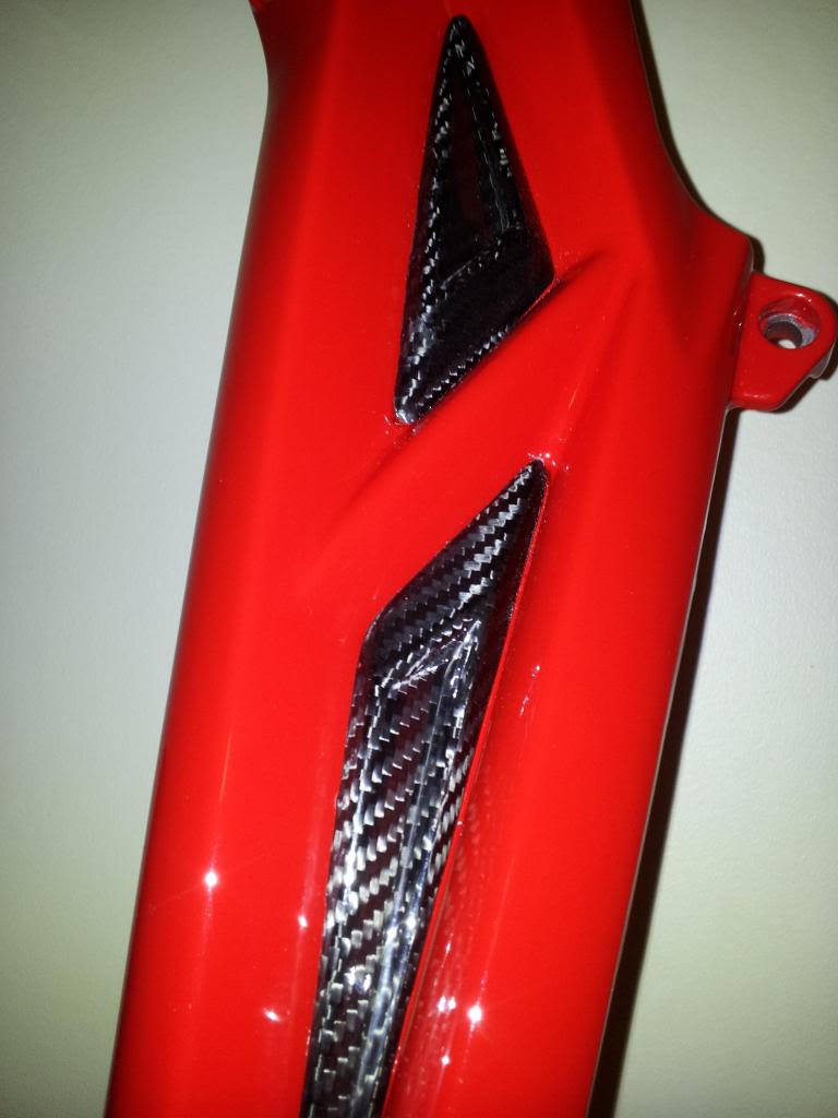

    Got some of the carbon stuff in the mail today, still missing the front fender + a few more random bits that i haven't quite decided on yet. No time to fit them all and re-assemble the rear subframe until this weekend so here's a preview :
    Thanks to Jac @ carbonfbr for getting the stuff to me fast and being a great guy to deal with !
    Hugger:
    Fairing inserts:
    Chainguard (upper) :
    Chainguard (lower) :
    Subframe inserts:
    Looks damn sexy if i may say so :)

    It can possibly be done without removing the subframe, i did it because of the paint job so i already had them off the bike. The fit of them isn't perfect though so some trimming might be needed, i had to modify the pins slightly and secure them with glue. The CF is much stiffer and less pliable than the oem plastic parts.
