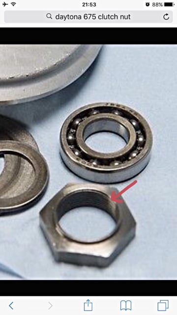

  11. stevemoir
    stevemoir
    614
    46
    Location: Aberdeen
    When the original went on you had to tap a part of the nut to sort of lock it in
    When I did mine to fit the slipper I prised the part that was tapped to allow the nut to come straight off
    And when the new nut when on tapped it again
    Pictured below - you can see the lip
    Steve

    Thanks Steve for clarifying
    The suter clutch I've put in comes with a new nut with a built in lip anyway, so thankfully I've not missed anything important
