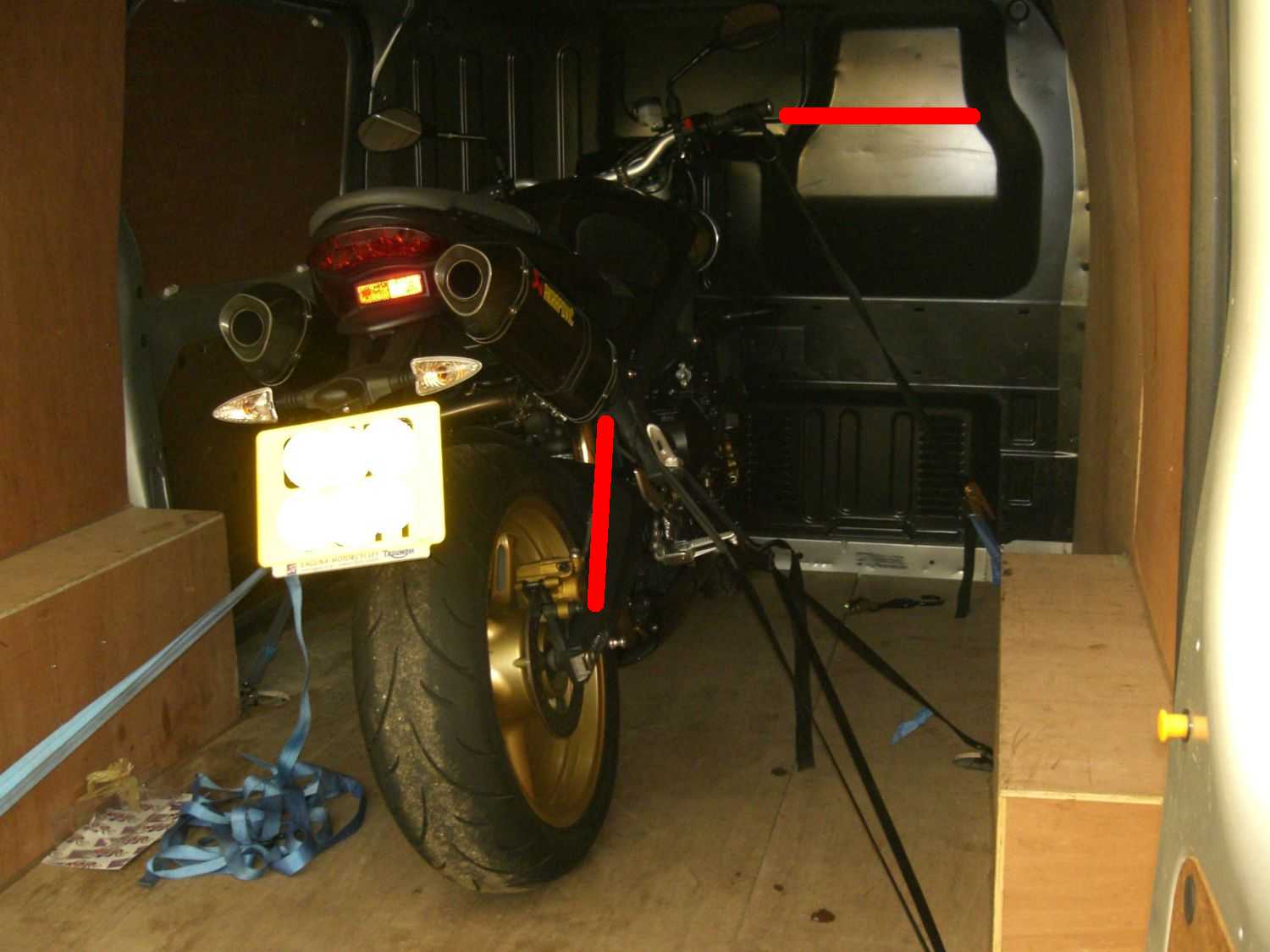

    Here is a pick of my bike secured in the back of a van if it helps. just make sure that the bike cant move forward back and side to side and it should be ok. what ever your happy with.

    Many thanks TJ :smileup:
    Your pic helps a lot. I thought it was logical, but being my first time, I wanted some "moral support" ;)
