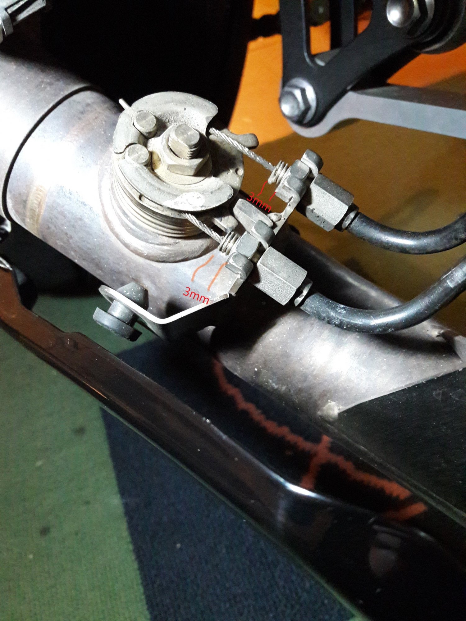

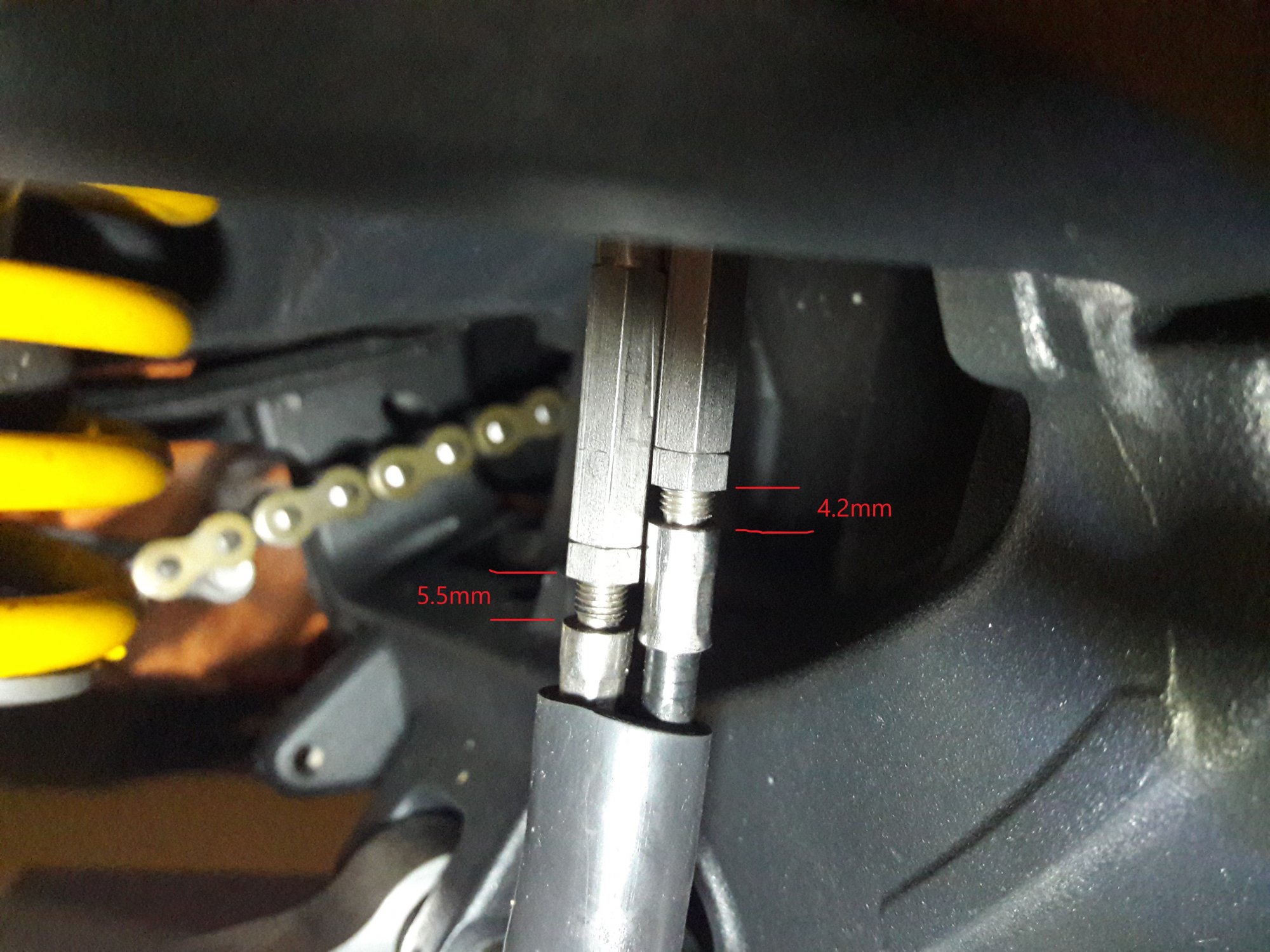

Don't know if these are any help, suppose it depends on the adjustment at the other end if there is any, I've never had my servo off. View attachment 54717 View attachment 54718 Thats in the open position, cable adjuster on the left is the "top" closing cable, which is the bottom cable on the servo. The manual shows the tension measurement in the open position, mine measures approx 22mm (centre to centre), maybe their 12-14mm should be 22-24mm, like I said i've never really gone off the measurement, just trial and error, I will say though it normally needs to be slacker than you'd think. If you need it in another position I'd have to connect to Tuneecu, but not sure it would even do the mid point set up as its disabled in the map, I'd have to send the map again with it enabled.

Just added some measurements to the pics, don't know if it'll help. I'll leave the cover off for now, but unfortunately I have to move two bikes around the kitchen to get access to that side
