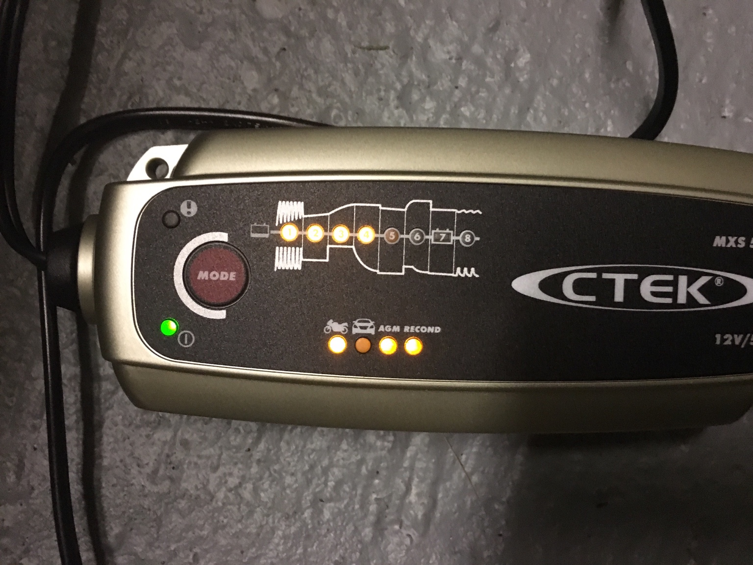

    My new charger came today and it's currently doing its magic to current battery I'm hoping for the best. Thanks for everyone's advice. I have looked into the YT9 but it's bigger and seems as though the battery tray is bigger in newer bikes to accommodate the battery.
  4. The mode you selected is perfect and it's good that it arrived at step 4. Step 5 is a test of the battery to see if it can keep the charge (AKA if it's a zombie). If it doesn't go to step 6, disconnect, leave for 5 minutes and try again. I had this issue with my car battery, but the second time it went to step 7 (100%).
    You do not need to wait to go to step 8. That is maintenance mode to keep the battery at 100%.
    Did you need to revive the bike battery with the car battery or the charger was able to recognise it (it had more than 5V)?

    Thanks for all your help, so it went through the full cycle first time so that was good, left it to charge over about 12 hours.
    Since the charge here are the voltages of the battery-
    12.7v- 1 hour after full charge
    12.58v- 9 hours after full charge
    12.52v- 1 and a half days after full charge
    So clearly still some issues but has improved as after a full charge using my old charger I was only getting about 12.3v. Happy I got the new charger (thanks for the recommendation).
    Next question is should I give the battery a full charger over the next 24 hours again without the "recon" mode on or do it with recon mode on to try it again?
  6. The manufacturer recommends recondition mode once per year or after full discharge.
    Keep charging without recond mode.
    But where did you keep your battery when verified the voltage? On the bike?
    Maybe something on your bike constantly consumes electricity.
    Do a check with your multimeter.
    This time you have to link it in series with the bike and battery and check the drawn amps while bike is of. If you don't have an alarm, it should be very low.
    Search on internet on how to correctly perform this test.
  7. The test is called Parasitic Battery Drain. Here is a video on how to perform it:
