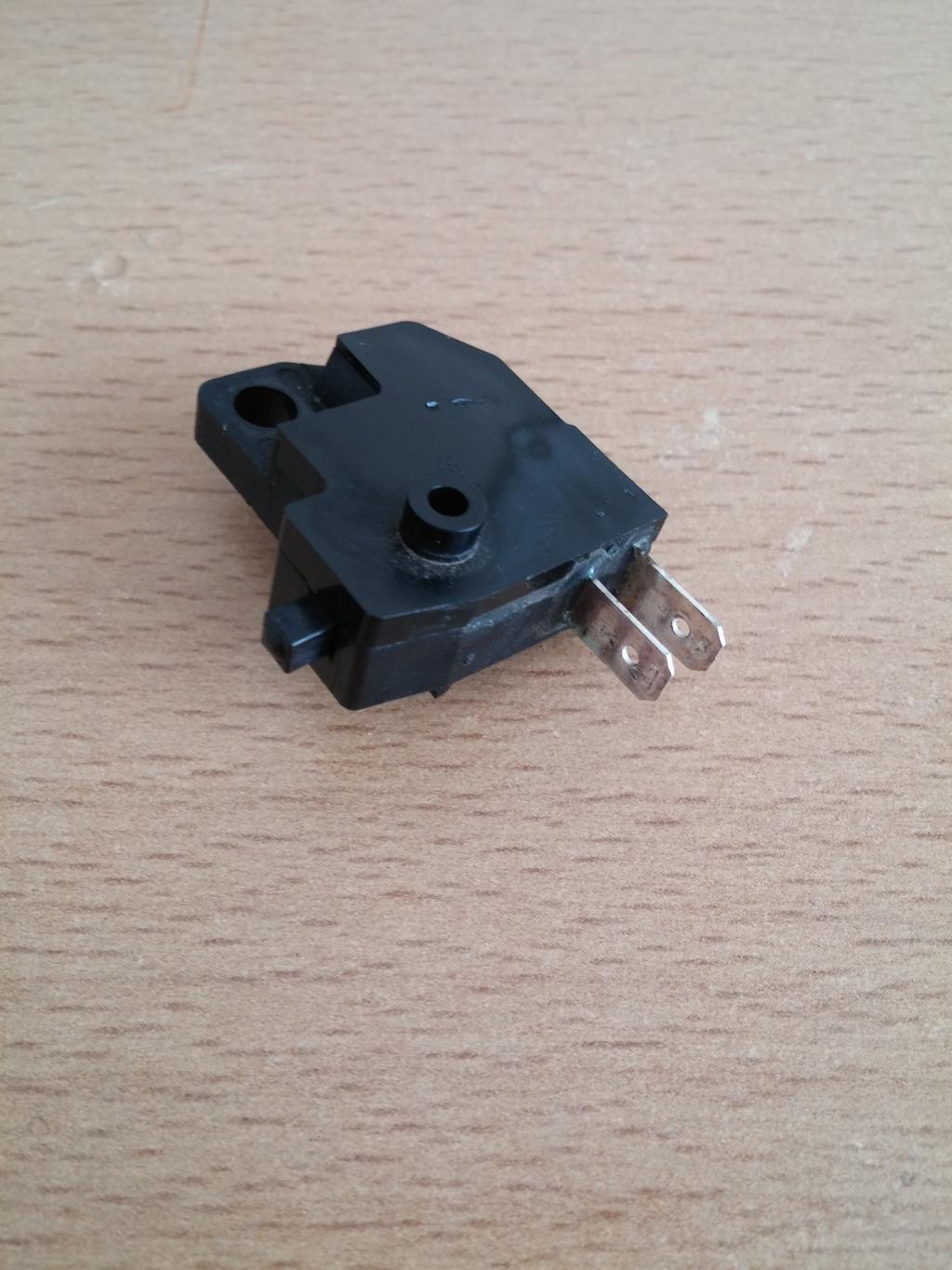

    Hi all,
    When pressing the front brake, it doesn't illuminate the brake light. The rear brake does.
    I've taken off the clicky mico switch from the front brake lever, and when you click in the button, the brake light flashes once, but doesn't stay on.
    Has anyone heard of this? Is there a simple fix?

    Thanks Capt, I found your original thread on this from last year, and took the advice to short out the switch connector. The brake light illuminates normally. So I guess I need a new microswitch!

    The front brake switch failed on my 07. Its an easy swap out for a new one.
    Got one from ebay, cost less than a tenner, easily sorted.

    I replaced my Kwack switch, 5 min job and about £8
