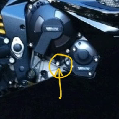

    Does anyone else's clutch cable rub on the fitted cover?
    It has no effect on performance, but the cable is eventually going to wear the cover and/or start to fray.

  4. p-trax
    p-trax
    1,874
    Crappy pic, blown up & cropped from iPhone.
  5. It touches the cover on mine as well. I check and lube it every now and then and it seems to be fine :)
  6. Dont touch on mine lol. There is about 1.5mm of clearance.

  7. p-trax
    p-trax
    1,874
    Strange, mine touches more then your pic, wouldn't of thought there was that much variation in engine or covers
  8. I know this is stupid, but have you tightened the bolt properly? Sorry for stating the obvious but can't think of anything else :?
  9. Touched on mine too, luck of the draw if it does or doesn't, I would put that down to the repeatability of the moulding/finishing processes, die alignment and mould fill etc. As above keep an eye on it and keep it lubed. U could always fettle it up with a dremel or similar so it clears.
  10. p-trax
    p-trax
    1,874
    All bolts torqued correctly, I think I'll just file a mm or two from the plastic
