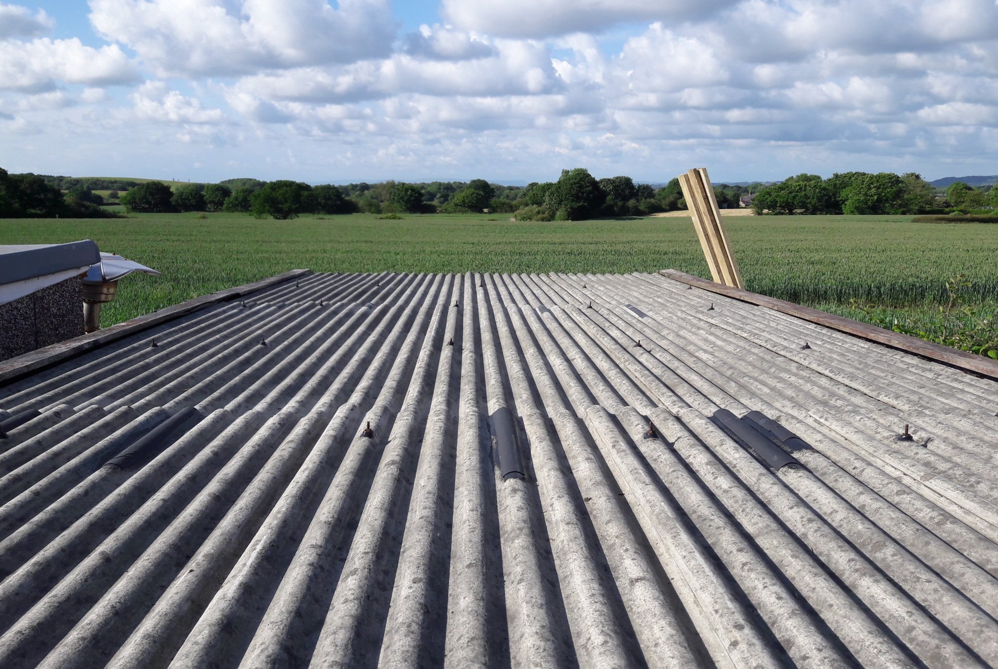

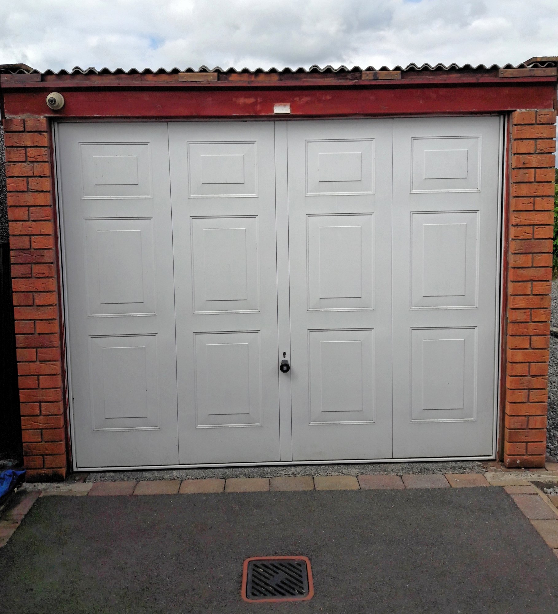

  9. Not work on the bike but whats the next most important thing after your motorbike, yes, where its kept;)
    Garage hasn't had any major work done since it was put up about 15 yrs ago, only a basic pre-fab concrete panel and the roof leaks a bit in heavy downpours.
    cleaned off all the moss and dirt, kneeling on wooden planks moving along a few feet at a time:mad:, sealed panels with sikagard, tightened all the panel bolts, sealed all the overlapping joints with gutter/roof sealant, repaired a few cracks with flashband tape.
    Next all the wood across the front facia and along the side edges will be stripped off, will run flashband tape all the way along the sides before fitting the new wood, there was just an open gap under the existing wood.
    Not very exciting pic:p
  10. StMarks
    8-)) Pretty cracking backdrop, to be working against Wobbley'. -I just hope the wind wasn't howling round you, like it has up here recently.
  11. Yes. not a bad view, looks much better from the top of the garage than my bungalow to be fair
    Another full day today but doesn't look much different though, stripped the rotten wood off both sides, primer applied then flashband tape over the gaps, new wood fitted on the left, have to use the other boards to work off as I've no access to that side, everything takes 10x as long dragging the boards and tools up and down the roof. Made two rookie errors, left a piece of wood on the floor with a nail sticking up:eek:, then kicked over a small tin of creosote all over my nice clean roof panels:mad:

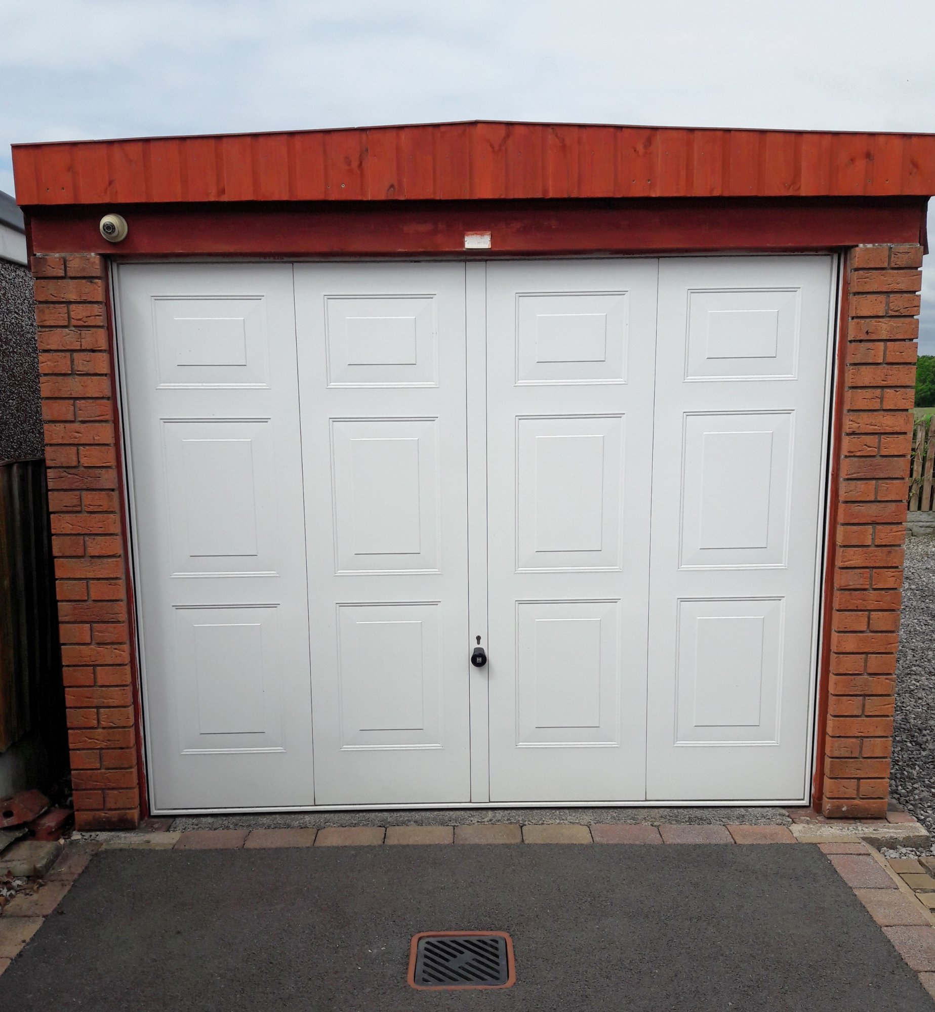

  13. Roof finished with a new facia across the top and improved weather strip along the bottom of the door, Still need to repoint the joint between the panels and the floor inside but have to give my knee's a break first.:(

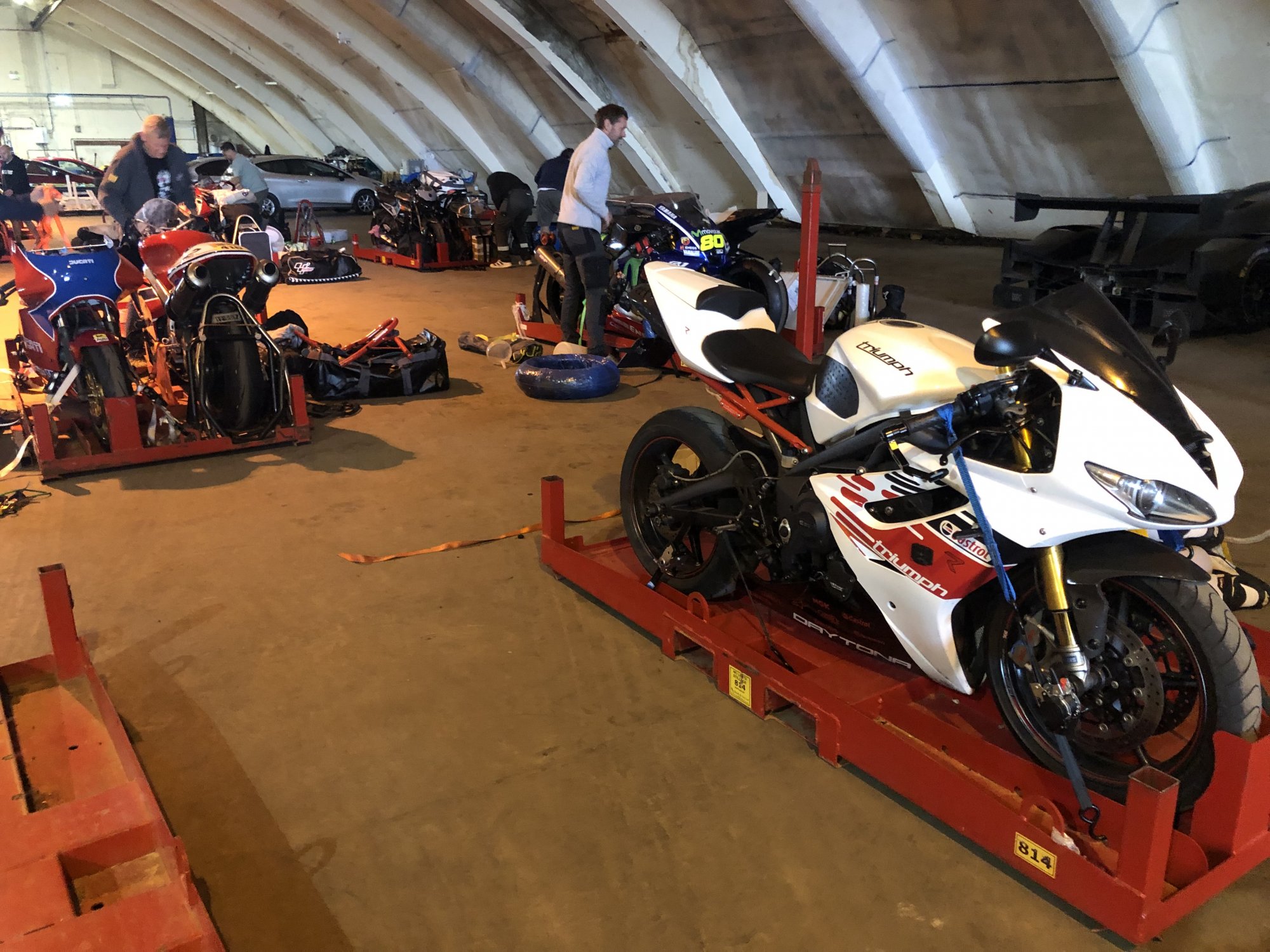

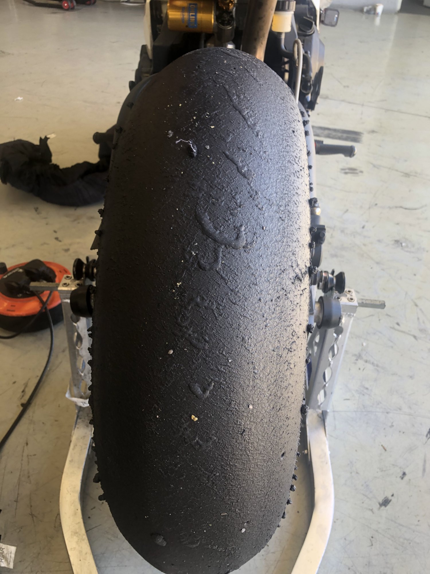

    Technically Sunday - but packed her up after 3 days nipping round Portimao on slicks for the first time - even a fried clutch pack & a trip in the recovery trailer of shame didn’t dampen the mood for too long - luckily for me someone had a spare 675 set & I only missed three sessions. IMG_1950.jpeg IMG_1966.jpeg IMG_1935.jpeg
    Best Euro track destination - brilliant track, great beaches, food & company :):binge:

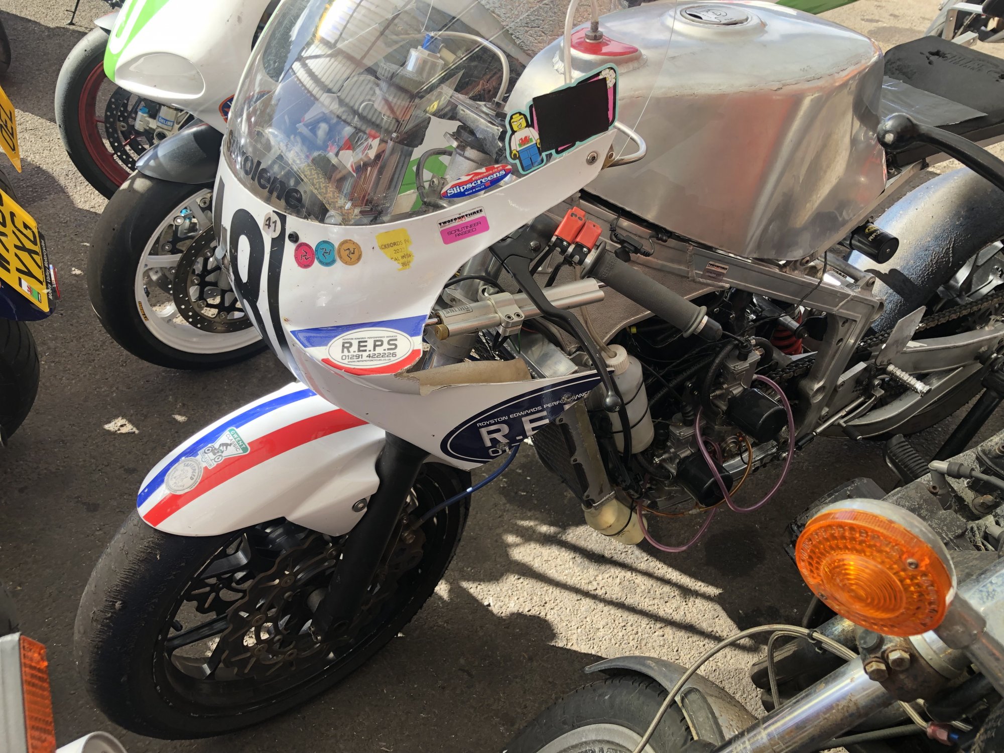

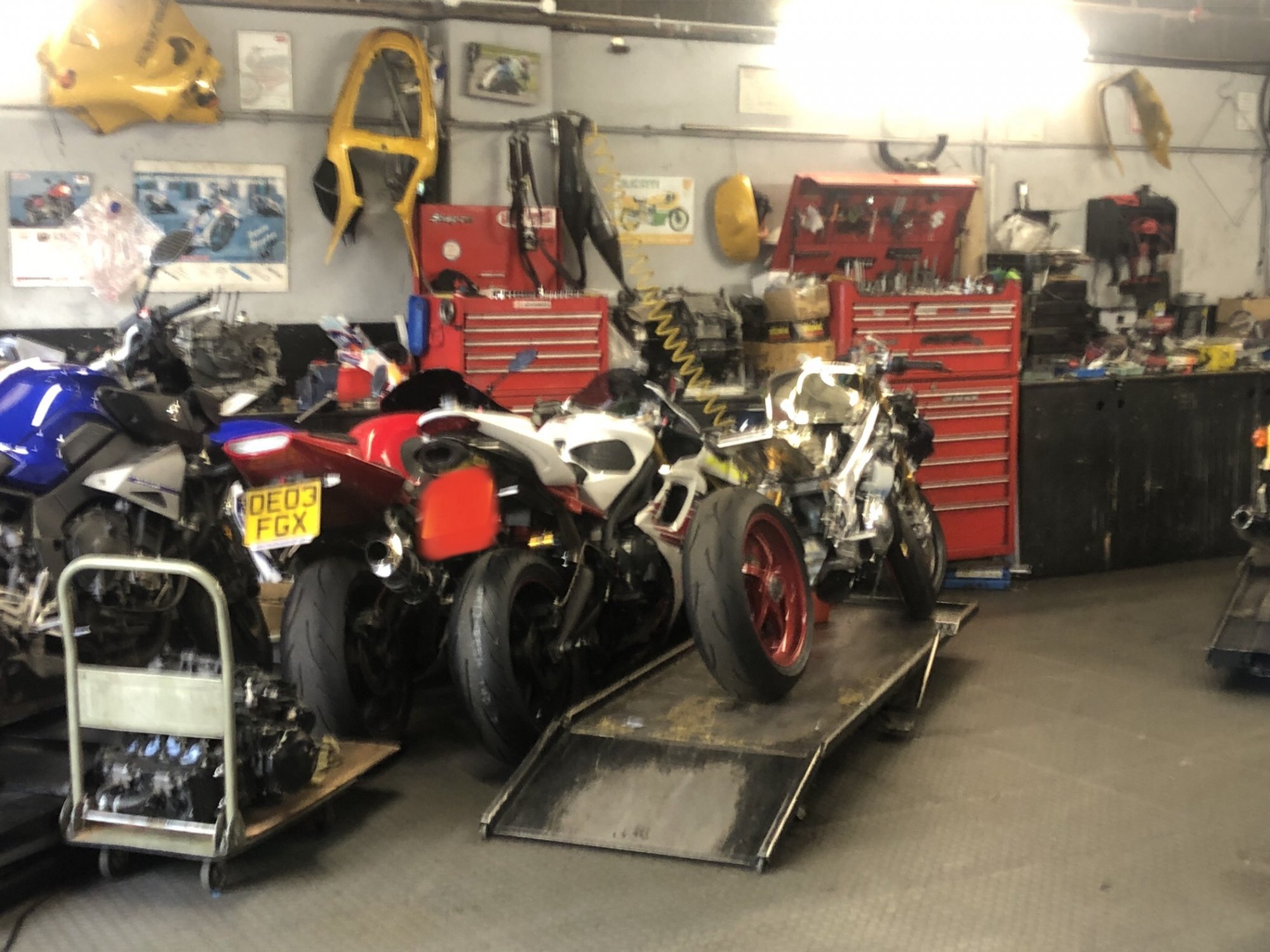

    Picked her up from my local race shop REPS in Caldicot after dropping it off on the way back from Portimao - clutch issue fixed/plates replaced (and they showed me how to measure/adjust it correctly), oil leak traced & fixed on engine cover gasket IMG_2290.jpeg IMG_2293.jpeg IMG_2297.jpeg IMG_2296.jpeg IMG_2299.jpeg , road tyres put on, stuck exup valve removed & bike remapped to get rid of the lumpy bits - sure I’d be 5-10secs a lap quicker now it’s back to full health & actually getting 113 at the back wheel again - and constantly…;):D
    Wallet certainly is a lot lighter lighter, but happy to support an independent occasionally for a good going over/remap & especially one that has great mechanics, races at the TT & Manx GP & fitted my bike in at extremely short notice:)

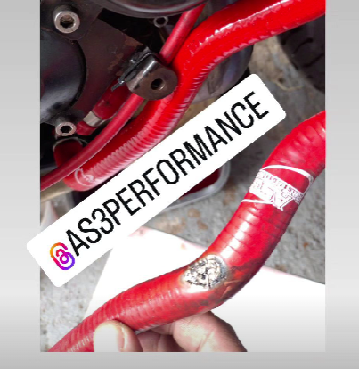

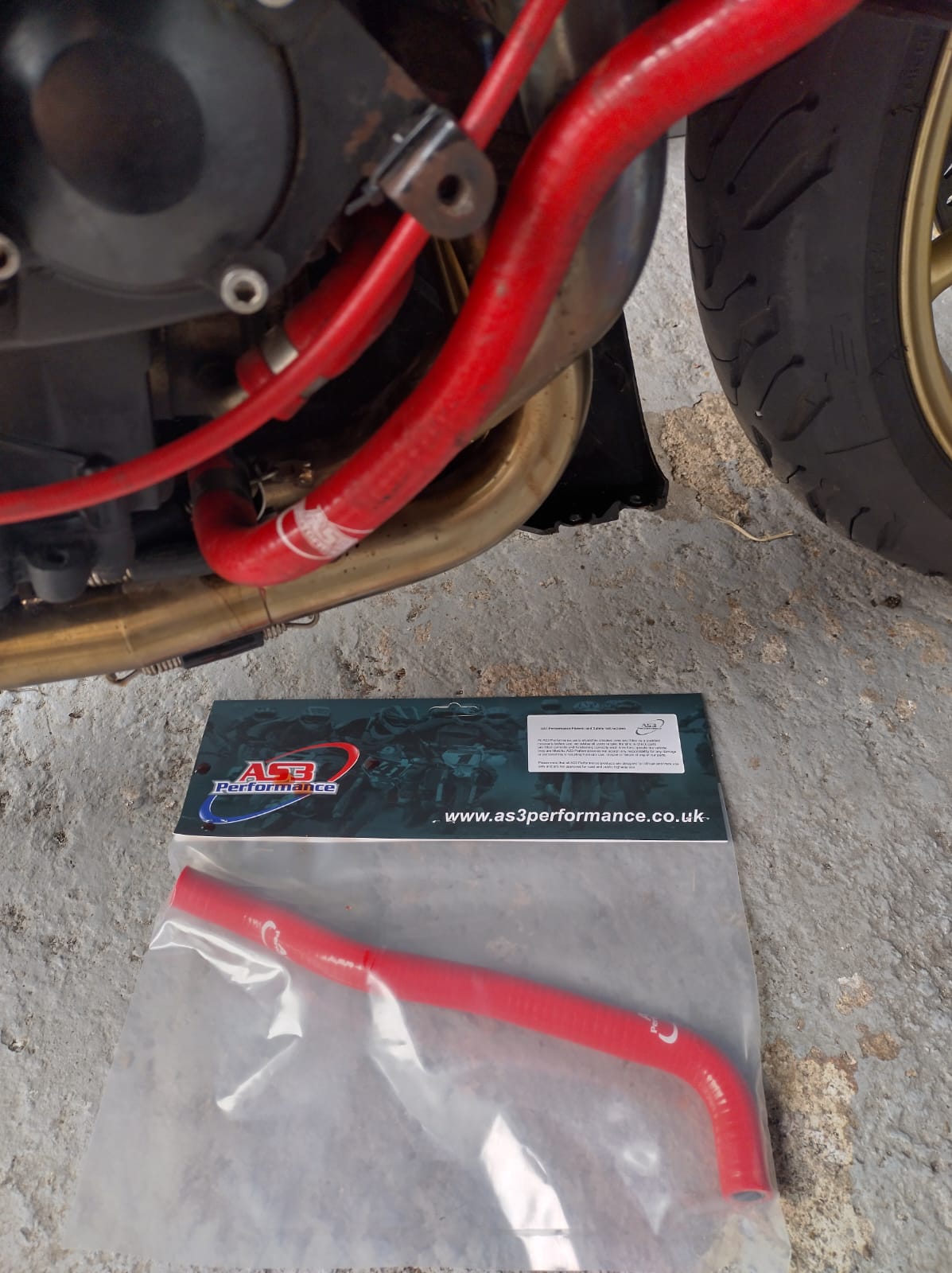

    Had a little date night/bike night with the other half and on the way the bike decided to create a moment where one of the radiator hoses decided to touch the new headers, next moment a bit of smoke and some coolant on the floor....
    We decided to head home, thankfully waterless coolant didn't leak out too much more and made it back to the house, spoke to the guys at AS3 performance who shipped out a replacement hose, fitted it today and made sure its not touching.
    And yes, it was caught on camera, so here's the link to the instagram post containing the very amusing and amazingly well timed moment the hose gave up
    https://www.instagram.com/reel/C8sUK6IoIJj/?utm_source=ig_web_copy_link&igsh=MzRlODBiNWFlZA==
    So enjoy
