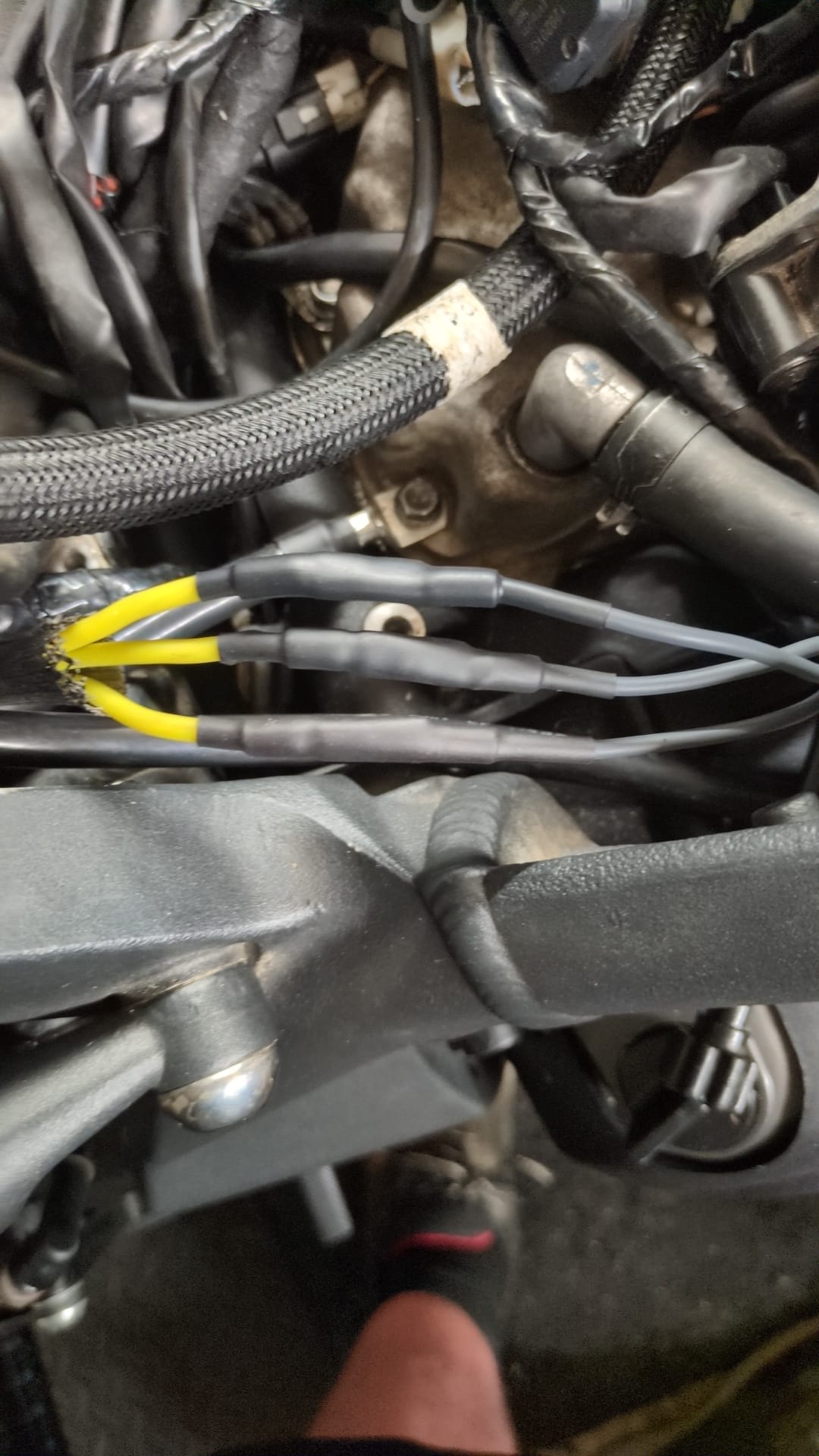

    Managed to get round to removing the stator to regulator plug, size of the thing
    Went the crimp connector route, lost a couple that failed the tug test, then lost a few more because I forgot to the put the shrink wrap tubing in place before putting the connector on. Silly me, but all three are now done, don't think they look too bad and they are all certainly tight and not moving. Lets hope they hold
